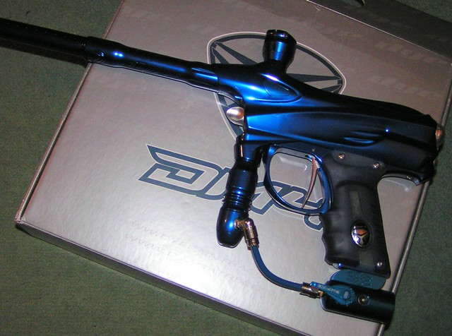

I owned a blue/black fade PM7 with a few upgrades a while back. It performed well and became a popular loaner within our team for 2 seasons. Needed minimal work to keep it running ok other than regular cleaning and greasing. I only off loaded it to thin the herd and raise cash for other deals in the end.
Don't discount the classics either. I picked up this mint DM4 on the forum for an amazing price. It came with lots of quality upgrades including Tadao chipped board, Evolve X-95 bolt kit, CP roller trigger and masses of spares. I've used it on a couple of walk on days and it shoots like a dream. Almost no kick at all, very quiet operation, zero chops and surprising efficient even in cold weather. Ok it may be a bit bulky compared to the latest electro's, but it gets the job done in style and is beautiful looking marker. I've swapped the empire ASA for a gloss blue CP direct mount since picture was taken.
