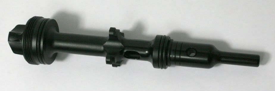

1 x G-R2 Prop Shaft Assembly

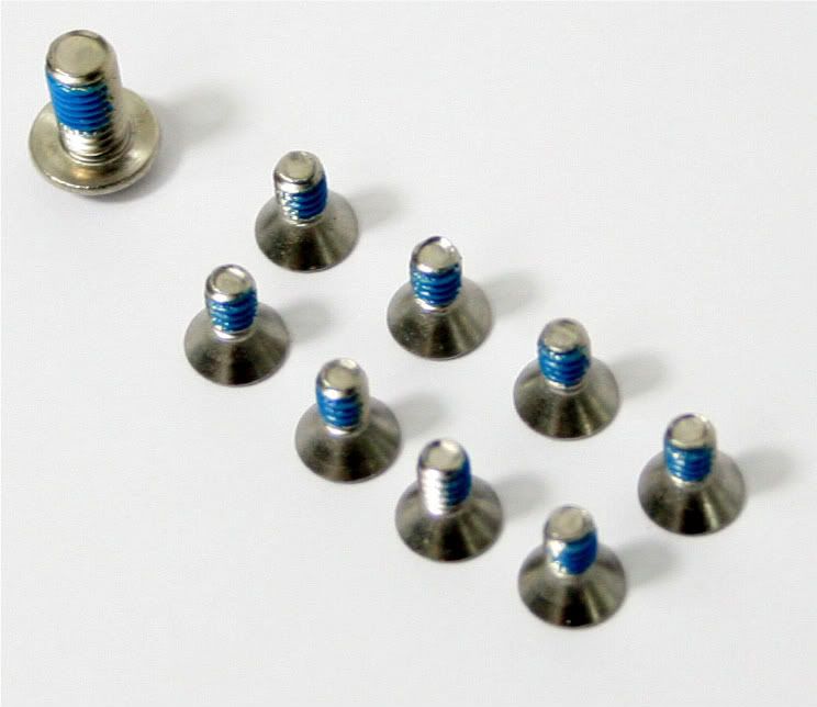

8 x Patched Eye Cover/Rubber Grip Screw
1 x Patched Rear Frame Screw

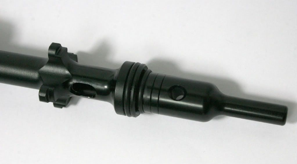

The new G-R2 Prop Shaft Assembly includes a new design of VVC screw to prevent the VVC backing out and leaking. A larger diameter O-ring and revised groove dimensions of the rear O-ring to prevent the Prop Shaft Assembly backing out of the Geo body during play. A new shortened “tip” allows the ball to sit further into the face of the bolt to alleviate ball breakages allowing you to shoot even more fragile paint. Modifications to the design of the VVC Screw Fore-Stop to further strengthen the design. The G-R2 Prop Shaft Assembly is easily distinguishable by the two grooves milled into the base of the tip:

The patched screws simply give eye covers, rubber grips and the rear frame screws a much tighter, secure fit to prevent any loosening during play. This helps take day-to-day maintenance down to an absolute minimum.

- If you purchased a Geo in 2009 then you will need to look at your Geo Prop Shaft to see if it has the double groove marking:
If there are no markings then your Geo does NOT have a G-R2 Kit fitted.
